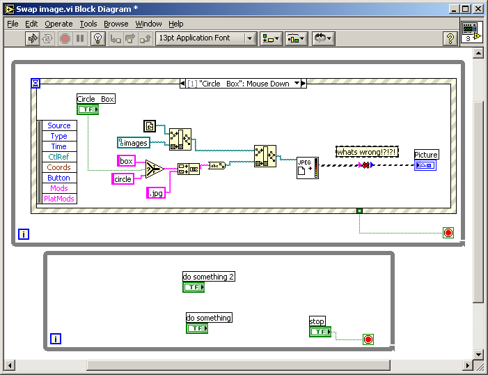

Now i tried to insert a picture in my vi and read a box-image or a circle image, depending on what I want as background.
How do you like this idea?
I have some problems loading and displaying the picture - I have no idea how to convert the jpeg-data into "picture-data". see attached vi. I have no idea what's wrong and I can not find any "jpg-to-picture"-vi     😞

I can not open LV 9.0-VIs
Could you please either save it as 7.1 or upload a screenshot?
Thanks.
BTW here is a screenshot of my problem:

Try putting the Draw Flattened Pixmap VI where your broken wire is.
