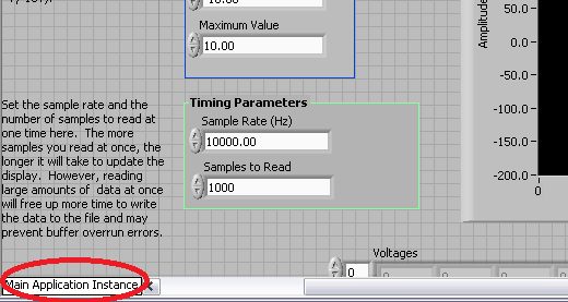

If you look at the bottom left corner of your VI, you will see the execution target.
You can right click on it the select different target if available.
20163i3E95D24AA37D06BC
