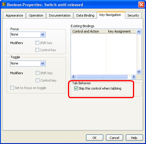

Now here is the right answer.Smiley Wink
Go to the properties for the switch, Key Navigation Tab.
Check skip this control when tabbing.

The skip control when tabbing forces the user to put the hands from the keyboard and use the mouse.
