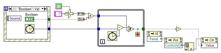

If this is homework, you shouldn't use Local Variables (read this post to understand when to, and when not to, use them).  Here's a way to do it without locals:
You can probably figure it out for yourself, but the string constant contains "\01\01\00\01\01\01\00\00\00\00\00\00\00\00\00\00\00\00\00\00\00\00\00\00\00\00\00\00\00\00\00\00".

I accept risking losing the solution and kudos by posting this, but my second post in this thread was intended for the entertainment of experienced LabVIEW programmers; it is intentionally obfuscated.  I apologize for making you the butt of my weak joke.
Jim
(6,618 Views)
I really hope this is the solution handed in.  That being said I think you'd get more kudos for posting obstruficated code.  If you answer for the OP you get one kudo for each post max.  If you post obstruficated code you likely get kudos from your peers that think it's funny.
