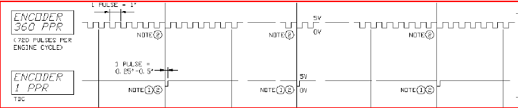

Basically, to generate pulse train as shown below.

Correct, you can't change the specs of the finite pulse train on your 2nd counter on-the-fly.  The purpose of the 3rd counter at 100 kHz is that you *can* change its freq on-the-fly, which would then *result* in changing the timing of the 2nd counter's pulse train in hardware rather than via programming, where it isn't allowed.
To keep 1st and 2nd counter synced, you *will* need both the 1st and 2nd counters to use the 3rd counter as a timebase and define their pulse specs in units of Ticks.  The 1st counter should have specs for low and high ticks such that their sum is 360 * (the sum of low and high ticks on the 2nd counter).   Once you get this set up right, you don't need the 2nd counter to be a retriggerable finite pulse train.  Now it can be a once-triggerable continuous pulse train.   Because the 1st and 2nd counters will derive their timing from the same timebase, you only need to get them synced at the start and they'll maintain hardware-timed sync as long as you want after that.   And because the timebase is a counter whose freq you can control on-the-fly, you can vary the simulated rotation speed any way you want and know that the 1st and 2nd counters will stay locked in sync.
