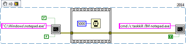

In this case you can use the System Exec VI to call the Windows command line function taskkill. This command will kill a named process. For example:
cmd /c taskkill /IM notepad.exe
This will send a message to notepad.exe to shutdown. If you want/need to forcibly stop a process, use the /F option:
cmd /c taskkill /F /IM notepad.exe
Note in both of the examples they begin with cmd /c. This is necessary when making command line calls using the System Exec VI (see the help for info).

Yes, you'll need two system exec VIs. One to start the vibration and one to stop it. The way you're calling taskkill isn't quite right. See the example below:
In your case the closing command will be cmd /c taskkill /IM effect.exe

I talked to my friend and he told me that I have to use string and boolean on this. I just double clicked the vi and typed the command line in there, so that was why it wasn't working + I thought "IM" was part of the notepad file name, so I didn't include that on mine.
Thank you for the example. Unfortunately, I didn't bring the joystick home today, so I cannot test it T.T
