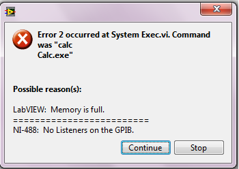

i have tried to run an exectable(ex:Calc.exe - which is for system calculator) using system exec.vi..
 But i'm getting the error as.. Can any one know how to rectify this problm..

Hi suresh,
it runs fine for me:
18455iBFB92C6CF2BAF759
You may try the command line "cmd /c calc.exe" too.
Edit:
Did you give the command as "calc calc.exe" as your error dialog says?

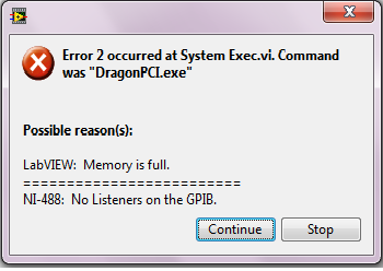

Now i'm getting calculator window...
i have one third party exe in the name of DragonPCI.exe which do simply read and write operation
in a FPGA board..
when i give DrongPCI.exe in the command line it shows me the same error..
18457iA37266BFEE9A6DD2

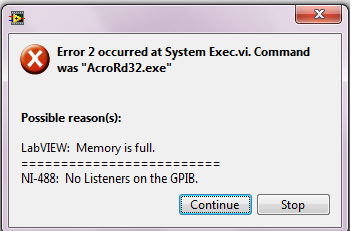

the same thing is happening for acrobat reader also..
18459i96C077A67F6BE512

Hi suresh,
when those programs aren't in the search path of Windows you have to set the complete path for the command!
Message 5 of 8
(5,540 Views)
