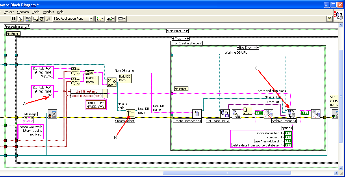

Trailing spaces are the worst!
A - Trailing space in this constant
B- Results in creating folder without trailing space but returns original path WITH trailing space.
C- Archiving distrubutes the files in both version of the folder.
And just for bonus points, Windows will not let you delete a folder with a folder spec. You have to use a DOS command to fix this. Smiley Mad
Ben
