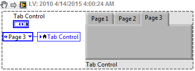

tab control - how to go to a specific tab when counter goes to zero?
I have a tab panel in my VI. Right now I would like it so that the VI goes to the last tab once a counter reaches zero (having started at 15 seconds). Any idea how I program that into the VI?

You have the solution to what you asked, but you might want to consider a different approach. Instead of using tabs, use subpanels. You can get the same user experience, and your software will be simpler and easier to maintain.
