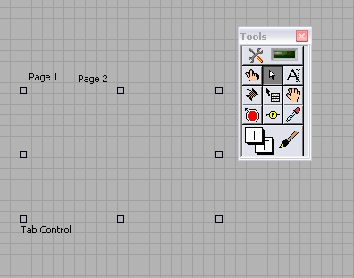

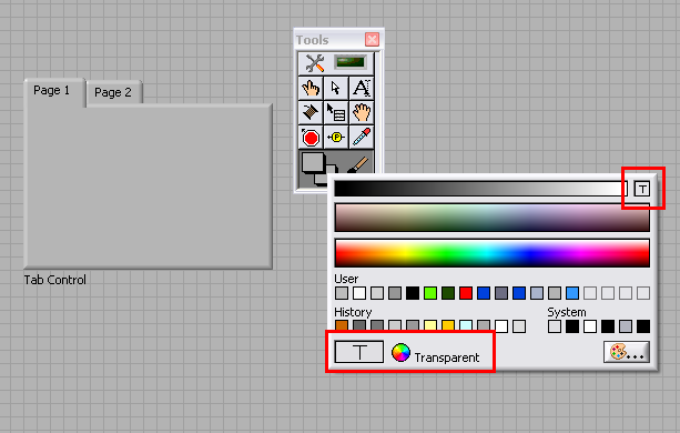

Hi
Open the tools windows and set the color - in the color dialog select the "T" top right of it.
Just have a look at the pictures:
In the second picture you don't see the tab anymore - just the squares of it when you move the mouse into the tab area.
As fas as I know, it is not possible to set different values of transparency.
Thomas
