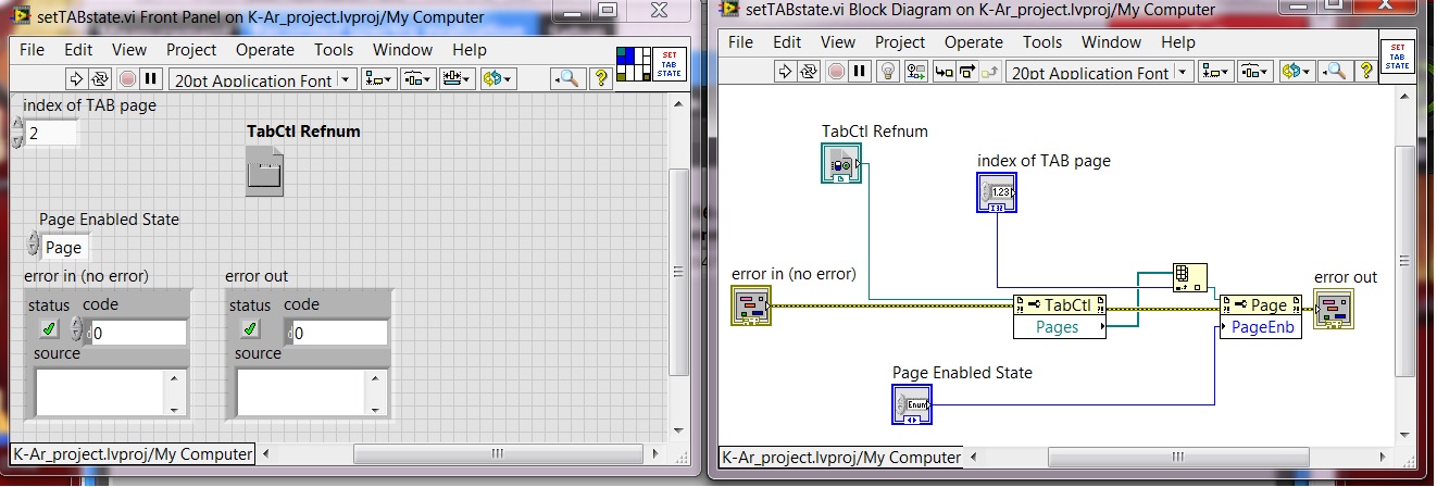

I have created a simple subVI (attached), what I would like to use whenever I need to enable or disable states of any TAB control.
However I can see there is a coercing dot when I connect a reference to the TABcontrol refnum input terminal. I am not familiar with labview classes, could someone give me a brief explanation, and tell me, is this a problem, or not? And how I can do a proper reference pass into a subVI.
(I do not have such a problem if I just use directly created property nodes on the top VI, however, I like to hide such a elements into subVIs)
Thanks!

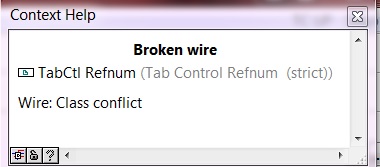

If I enable the Include data type, the wire between the TAB (I use two different TAB controls in my main VI with this subVI) reference, and the subVI input terminal gets broken. If I check it with help, I get this info:
Strange, because I made a test VI to reproduce this behaviour, with only including one TAB control. With this test VI, your solution works.

Tab controls are similar to enums (e.g. if you wire them to a case selector, you can create cases for each tab), so each tab control is different in exact type. Your subVI is for a generic tab control, not a specific instance.
You can safely ignore the coercion dot, it just alerts you to that fact.
(Similarly, if you wire two different tab terminals to an equal funcion, you get a coercion dot on each input.)
