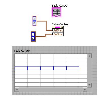

I am using a table control in a VI.
Is there a way to disable multiple lines being highlighted when the mouse is dragged across the table?
Rick.

Hi Rick,
        Just to make sure I understand, you are asking how to disable selecting multiple lines in a table.  I imagine you scrolling across a table selecting a line and accidentally moving the mouse up or down selecting a second line.  Is this the issue you are trying to avoid?  There are a number of ways that you could potentially resolve this issue using property nodes of the table control.  If you can list what you are specifically trying to do, we may be able to find which combination of property nodes is  best for this application.  I've posted a screenshot of programmatically selecting a single line of cells.  Have a great day.
