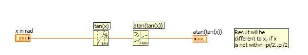

i try to test the tangent of arctangent of x normally its aqual to x but when i run i found another value so why ?
and why the tan(arcTang(x)) not equal to x ?

Think DATAflow: Your VI calculates the arctangent of the tangent of x.

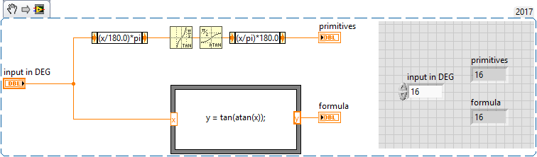

Same here, at least halt of it, the upper part is the arctan(tan(x)) and hence another calculation than the formula node.

I'm sorry for my previous reply, I mis-read the question of the OP.

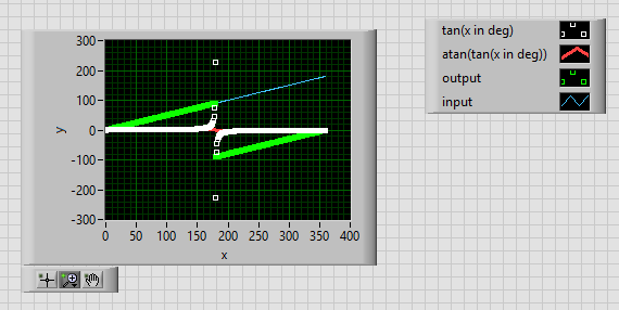

@zaki_Khan: tan(arctan(x)) = x is only valid for x-values (in rad) between -Pi/2 .. Pi/2 (or -90° .. 90° in degree).

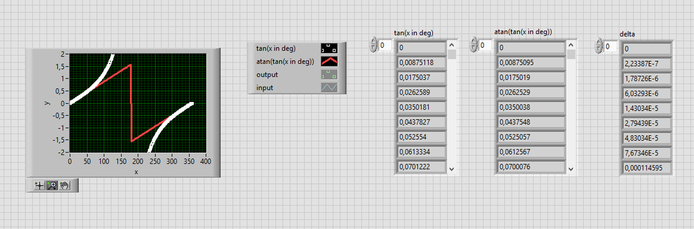

All trigonometric functions are periodic. This means for every Y, there is an infinite number of valid X values. The inverse function will give you an X that is normalized into a defined range. Check the help what the normalized range is (e.g. 0..180, -90..90, etc. or the equivalent in radians).

Also don't forget the Two input inverse tangent function Very useful because it maps into all four quadrants.
