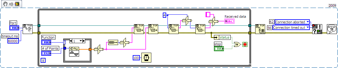

Thanx for the help....i need to establish a connection between kuka robot (labview not installed on it) and my pc.Robot sends me an xml string with its current co-ordinates and i have to update those co-ordinates and send it back to robot when i do  that it shows "670" bytes written but its not reflected on robot side.This is a real time operation and on robot side os is vxworks  so do i have to use rt communication wizard or is it possible through normal tcp\ip vi.I have attached the vi which i was using....thanx again fo da reply
