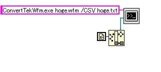

Hi Drew,
You must have hand handled this issue,  but I am posting workaround for future reference.
File converter is on the Tek web, see link below.
 TEKTRONIX WINDOWS OSCILLOSCOPE WFM CONVERTER
 httpwww2.tek.comcmswptswdetails.lotrct=SW&cs=sut&ci=12389&lc=EN
Calling this file converter exe file on LabVIEW like below, you can get txt file.
Hope this helps.
