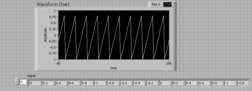

hi guys and gals, i'm making a little test program where i generate a sawtooth signal and i want to turn on a led (indicator) when the signal is 0. now i know that it will be 0 every cycle but what i want to do is, start a timer to go for 1second (lets say) and in that one second if only 0's happen then turn on the led but if there is anything other than a 0 leave the led off.

Do you mean here your led should be on if there is a zero between -1 to the next -1?

i mean if the signal suddenly stops and flatlines, thats when i want the led on (so its 0 consistently for a period of time)
