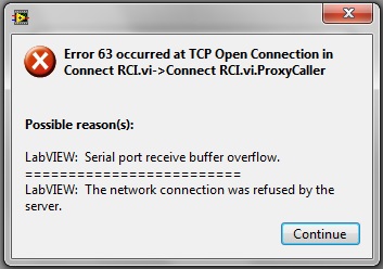

If I run the Vi on this system it give me the following error:
If I run the executable it doesn't error but it doesn't toggle the relays on my test system that is connected either.
