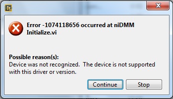

My bad, in my last post I included the following error which was related to an RCI
connection and not related to the topic...
If I run the Vi on this system it give me the following error:
This is the error message that  I meant to post:

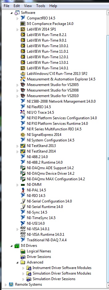

The same way you installed it on your existing setup. You should have a drivers disk. Otherwise, download it. Check MAX to see what version you are currently using. Check for other hardware drivers you s are using now such as NI-VISA.

Thanks Dennis
I looked at the MAX and I am seeing several versions>>>
Message 15 of 29
(2,325 Views)
Your comment does not make much sense. You appear to have one version of NI-DMM, one version of DAQmx, one version of NI-VISA. You also have IVI drivers and these would require the IVI Compliance Package. All of these were something to had to install on your original pc. Did someone else do that for you?

No, when I made the deplyment of my VI, I added all of these to it so that they would load on my test PC.
Then when I deployed it they were all copied over and once they were, I received critical update notifications.
What I am missing is some good instructions on how to set this test PC to run teststand and have it launch labview VIs
with only a Time engine installed...

Since you installed the dmm driver, can you launch the test panel in MAX?
