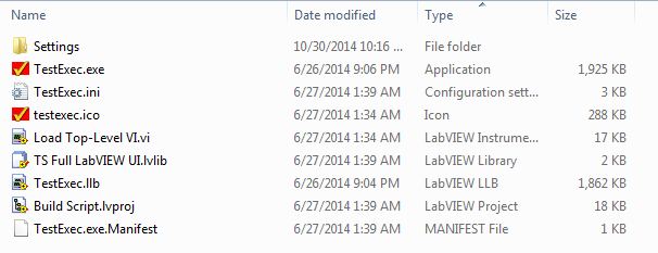

Start here: <TestStand>\UserInterfaces\Full-Featured\LabVIEW\Source Code
Jim
