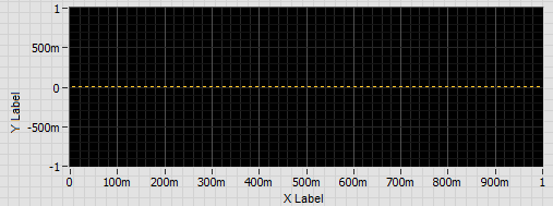

Maybe related to this:
Obviously the Y label is not centered, but there's no way to move it. And no, no spaces in the label. See attached VI (LV2012).
The y labels just seem to be torn down by gravity occasionally Smiley Mad
