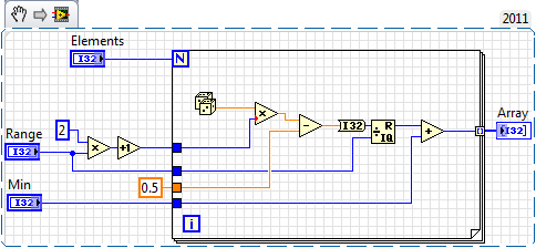

I'd like to point out one other issue about generating random integers that was overlooked in some earlier examples.  the rounding of doubles as implemented per IEEE754 causes a less than ideal distribution of the end points (0 and 45 will be 1/2 as common as 1-44) if implemented per RF and X's first posts.
Altenbach's solution of course does not have this problem but is limited to the case where duplicates are not permitted.
Consider the following Snippet as a general solution
The multiply by two and mod math are there to force the range generated to be even  otherwise if the range was odd an outsid cance exists that Random Number is 1 and and an Odd.5 would round up (x.5 rounds to an even integer)  forcing the range to be even prevents that from happening.

some purists might point out a minor improvment Smiley Tongue
That is exactly what I said in message 3 which is why is said to use the Round down to Nearest integer version.  The rounding of 0.5 to even integers only applies to the Round to Nearest function, not the Round up or Round down functions.
There is an issue with doing round up.  The random number goes from 0 to .99999......  So if  you round up after mulitplying there is a slightly higher distribution to 1 then it is to the max value you are going for.  Any number from 0 to 1 goes to 1.  Any number from 44.0000....0001 to 44.999999....  goes to 45.  Any number through the range would be 23.0000....0001 to 24 would round to 24.
The round down does not have this problem because 0 to .9999999 will always round down to zero, 44.0000000 to 44.999999.... will always round down to 44.  Likewise for any number in between.
