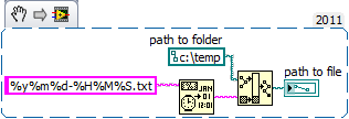

I have gone through all the solution given to others in this forum regarding putting date and time in file name and made this block diagram attached here but in final path indicator field i am getting <not a path>.  Can anybody tell me where i am making mistake.

can't open your VI here, but this should be easy like this:

Hi Gerdw
Thanks for the solution i got result that neede.
