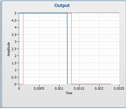

Hi everyone. I want to generate voltages by use of NI USB-X 6353. When I tried to use example vi "Voltage - Finite output.vi", I realized that there is a time delay between two generated waveforms. This is an undesired situation for our application. Why does this delay occur? How do I make it to generate simultaneously?

On the Basic Function Generator VI there is an input called Reset Signal.  Set that to TRUE.  What is happening is your second waveform is just being a continuation of the first.  Since the parameters for the first waveform say it needs a little more dead time, you get that dead time at the beginning of your second waveform.

Thank you very much Crossrulz. I get it.
