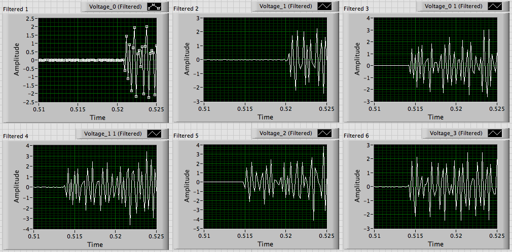

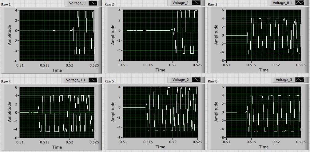

You have some problems with your data.
Put graphs on the raw data and on the filtered data.  Notice that the raw data shows saturation or clipping and that the filtered data appears to be at significantly higher frequencies. Also the filtered data is probably undersampled as most cycles have only 2 points.  If you want to reproduce waveforms reliably, you need to sample much faster than the minimum Nyquist rate. Since your filter is set to 1500-2500 Hz, the sample rate should probably be > 25 kHz.
What is the frequency of the excitation signal? What is the waveform?
Lynn

Ah ill have to go back into the lab to repoduce more data, but the sound it's self was orignally a hammer hitting wood and then each source is a microphone, orignall we had a higher rate and it was working alright, but when we had 2 daq assistants it asked us to change the rate down to 5k per 20k samples so i'll try upping the rate again to see if the input's look any better
Dosent seem to be anything else wrong with the setup as far as you can see ?
Thank you Lynn 🙂

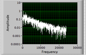

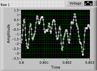

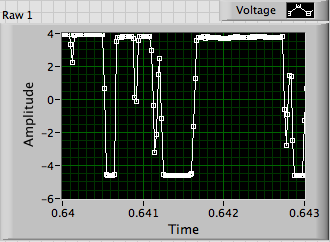

Shaun,
It looks like there are two issues.
1. The amplitude is too large at the beginning of the response.  From about 0.6 to about 0.75 or 0.8 s the top peaks are clipped. For part of that time the bottom peaks are also clipped. The worst problem is that it appears that an amplifier somewhere in the system is slow to come out of saturation. This broadens (prolongs) the clipped peaks. That makes any timing derived from that data questionable. Compare the 30 ms segments shown below.  Notice that the clipped signals have a much lower frequency than the non-clipped signals.
2. I ran a spectral analysis of the segments shown in the graphs above. The clipped spectrum is only about -30 dB at 24 kHz. The non-clipped spectrum is down to the noise floor (~50 dB) at about 12 kHz.  Look at the non-clipped data above. Between .801 and .802 (1 ms) there are 4 or 5 cycles of the data, which means that the frequency is 4-5 kHz. To satisfy the Nyquist criterion this signal needs to be sampled at >10 kHz.
To make your location measurements, you need undistorted signals. The clipped signals are unsuitable because of the time it takes to come out of saturation.  You cannot use data from late in the pulses (such as the 800 ms non-clipped graph) because you have no reliable way to correlate the data between microphones.
Do you have a tuning fork? Preferably one with a frequency of 1 kHz or lower. Mount the tuning fork at the location to be determined. Then tap it lightly with a rubber mallet (or a ball point pen with a soft rubber grip). If the signals received by the microphones are sinusoidal, then you have avoided the clipping issue. And by using a known, lower frequency, you can use a lower sampling frequency.
You still want to use the highest possible sampling frequency so that you get the best possible timing/phase resolution.
Lynn
