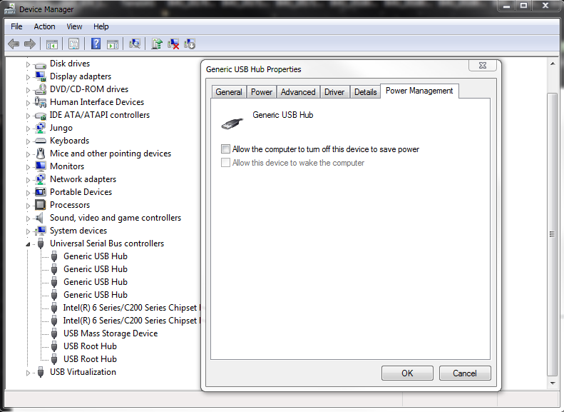

In the Device Manager check all your USB hubs for this setting
Device ManagerDevice Manager

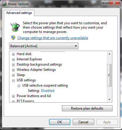

In the Power Management disable selective suspend
Power Management settingsPower Management settings

thanks a lot.
i did exactly what u said.
unfortunately the problem continues. any other ideas?
thanks a lot for your time.
