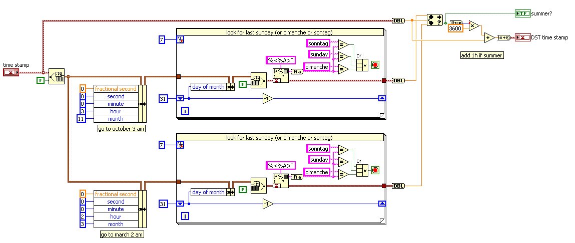

here's my solution :
Between the last sunday of march 2am and the last sunday of october 3am I need a add 1h.
This solution supports english, german and french, not sure that it's necessary (haven't checked)... I assume VxWorks targets only speak english but I had a doubt, and when in doubt use brut force!
