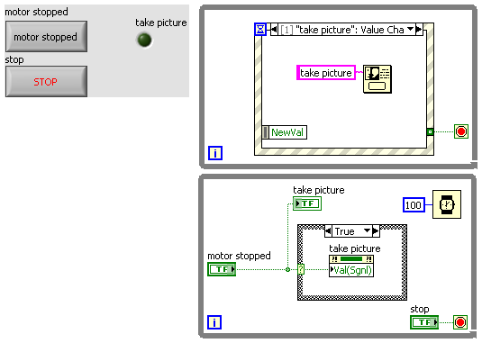

(3,971 Views)

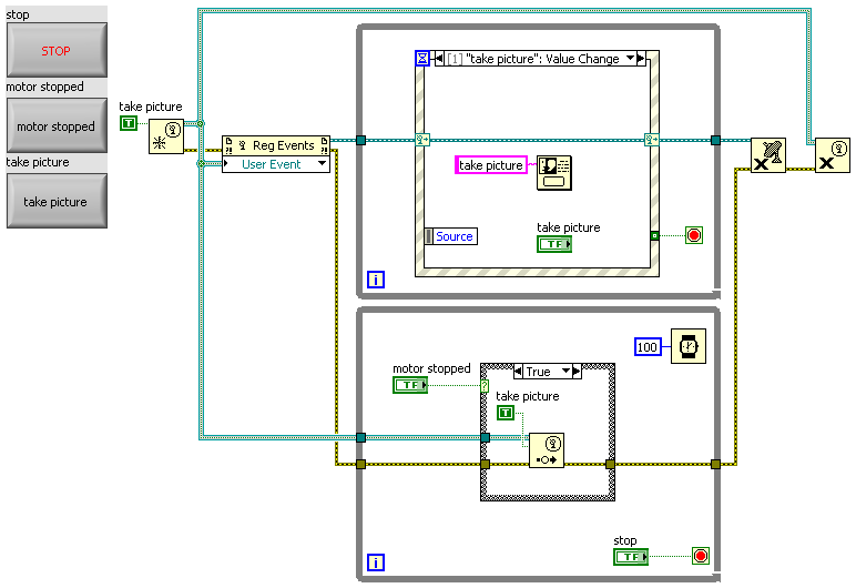

you could also do value signal....
