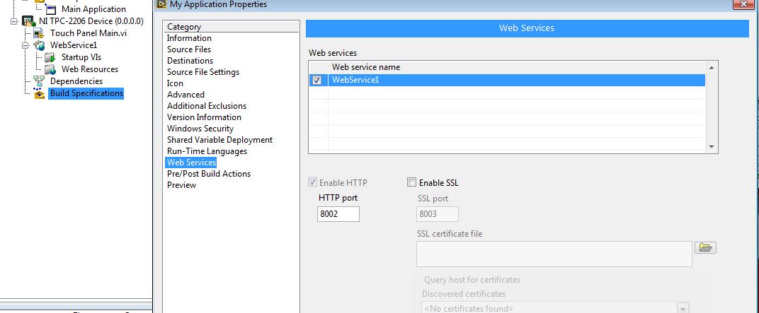

In the Build Specifications, there should be a category for "Web Services"

Using the web service configuration in the build dialog, I can get the unsecured web services running, but the ssl fails to run correctly. Unfortunately, all I have to go on is error code 363507 on my pc program which says it cannot verify the authenticity of the server. Sooo, I would like to make sure that ssl is enabled and the port is valid (I've tried 10 other ports without success). Maybe its something with the certificate? Unfortunately the only location I know to create certificates is through the web based configuration which of course will not run.
I can go into windows services and see the ni system webserver is automatic, and it immediately closes once started. The application server is also automatic..... So I'm guessing these only run when my executable is running. I still can't open the web based system config when I'm running my executable.
