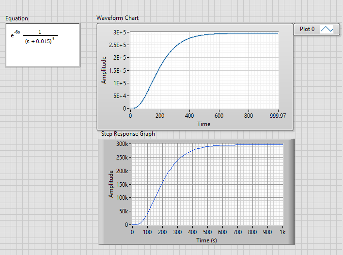

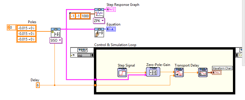

I have a transfer function with exponential of an medical jnstrument I want to control this TF with pid controller to see the response of it  G(s)= e^-6s /(s+0.015)^3

Hello Hazzaa22
If you have the LabVIEW Control Design and Simulation, it is very simple to create a Transfer Function with delay. In your case, if you use the Zero-Pole-Gain representation (ZPK) and use the delay, you can easily get the simulation. However, if you want to use the transfer function with the Control and Simulation Loop, you have to represent the delay separate from the Transfer Function. Here is the whole code:
Here is the example:
