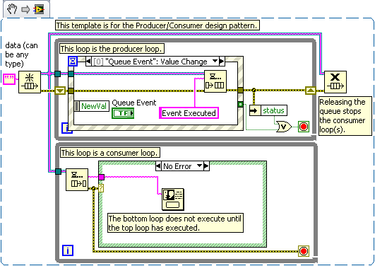

However, you have want to detect many control status. I recommand you to use produce-comsumer structrue.
Like this
you can go on NI website : https://www.ni.com/en/support/documentation/supplemental/21/producer-consumer-architecture-in-labvie...
Patrick
