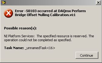

Thank you. I combined two loops together but still doesen' t work.It always shows:
Message 4 of 21
(3,916 Views)
Thank you for your reply. It seems that date that was read by USB Karte can only be used by one loop, because it always shows calibration.jpg

I told you that you would get a resources reserved error and I told you how to fix it. Did you bother to confirm what I said or did you search for the error code to see the numerous other new users that have made the same basic mistake?
