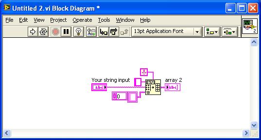

Hey Elyan
As Mike wrote this is what you could do.
stringToArray
If you want to load your string input from a txt file you need to use the read txt file subVI in the File I/O palette.
Sletten
