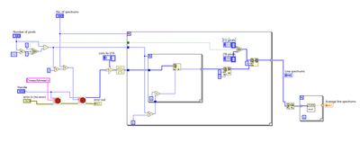

I am trying to write a c code from a labview vi.
Red colored blocks are FTDI write and read.  I have done the write and read operation.

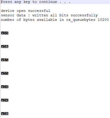

The output of read is as follows
Now I have to perform the type cast and byte swapping function to decode the data.

What's the datatype of the blue array coming out of the read function? (pictures are a poor way to show LabVIEW code! Who wrote it? looks very clunky!)

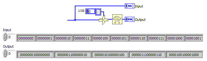

Typecast just re-interprets the raw bits as a different datatype. Just display the before and after in binary padded to the number of bits in the datatype to see what's happening.
