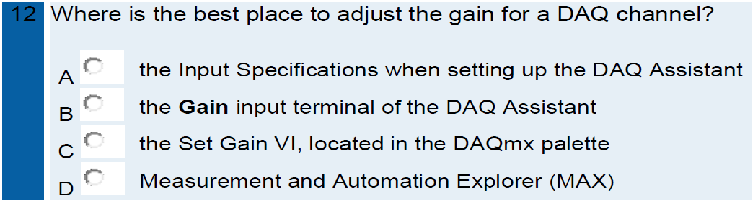

Hi friends,
                 I have started to prepare for CLAD exam. I got some unknown questions when I take online exam. Those questions are given below. Please postyour answers with reason.

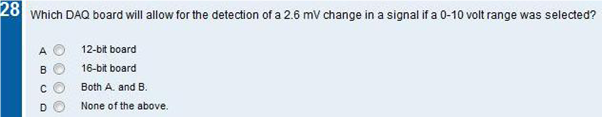

Which DAQ board will allow for the detection of a 2.1 mV change in a signal if a 0-10 volt range was selected?
a. 12-bit board
b. 16-bit board
c.Both A. and B
d. None of the above.
I couldn't  find the answer for above question. Please send the answer withway of calculation.

Range / 2^bits = smallest detectable change.
E.g.: 8 bits = 10V / 2^8 = 10 / 256 = .039V (39mV)
E.g.: 12 bits = 10V / 2^12 = 10 / 4096 = .00244V (2.44mV)
