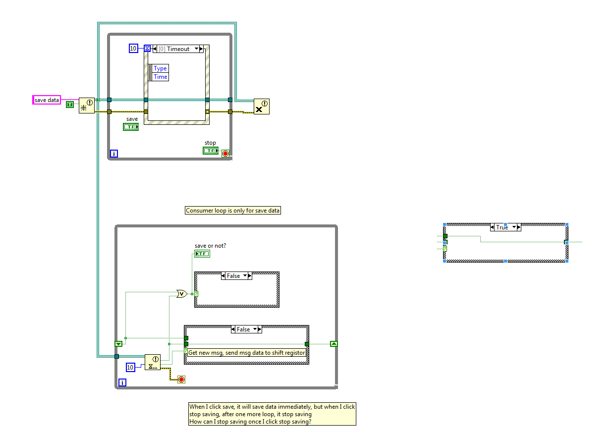

Thanks.
I made like this
When I click save ,consumer loop will start save immediately
But When I click stop saving , after one loop it will stop. because the SR value is still true, so saving data loop will run one more loop then stop
Is there other methods to improve this?
Message 7 of 17
(6,065 Views)

you are stopping the second loop on "error" only...if you want to stop, you wire a stop local to the second loop or send a messege "stop" to a "stop" case with a true bool wired directly to your 2nd loop stop
