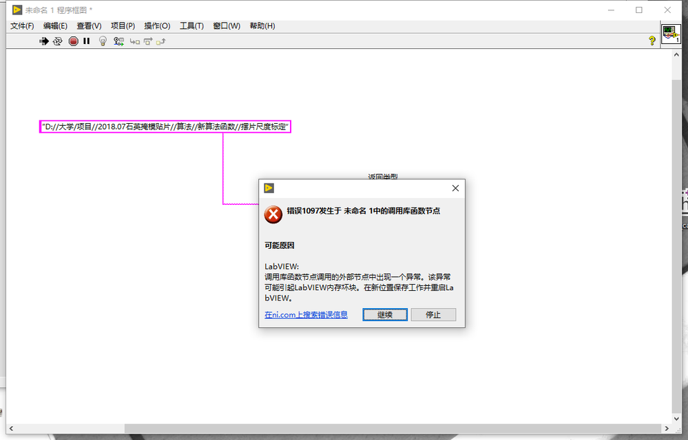

hello,everyone.I met a big problem in using the CLFN to call a DLL ( in C code )which is writed by using some library functions of Opencv,I tested the DLL in Visual Studio 2015 and it made it,but when I try to use the CLFN of Labview to call this DLL,it didn't work and the error number is 1097.I have tried many times and still failed.Cause it was the first time that I have tried to using the CLFN,I hope someone can give me some detailed steps about how to using it to call a DLL written by using some library functions of Opencv.

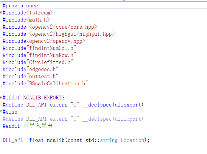

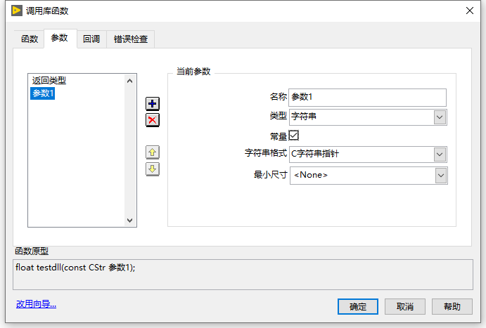

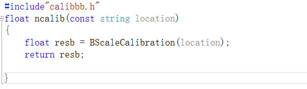

A std::string parameter data type is NOT a CStr!!
std::string is a C++ object, a CStr is equivalent to a simple char * parameter.
LabVIEW can not generate C++ object data types, mainly becuase there is no standardized way how the binary representation of C++ objects is implemented and about memory management of object pointers (from which heap are they created and destroyed).
So you need to change your C(++) code to accept a char *Location instead. C++ should be able to do auto conversion between the incoming char * byte array to the required std::string for your function but for other OpenCV C++ data types you will need to make explicit conversions between the standard C types (or possible native LabVIEW types) and the C++ objects OpenCV normally requires.
