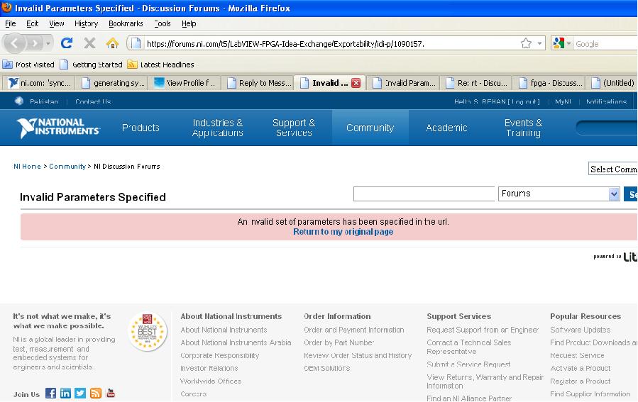

the idea exchange link you send is showing this errror msg

For some reason it included the ending period in the link.
https://forums.ni.com/t5/LabVIEW-FPGA-Idea-Exchange/Exportability/idi-p/1090157
