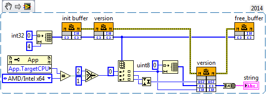

In addition to what Nathan said you have most likely an alignment problem. C compilers tend to align elements in a struct to their natural inherent size. That means the char pointer will be aligned to 4 bytes when you use LabVIEW 32 bit bit and to 8 bytes when you use LabVIEW 64 bit. Now since the DLL provides also both the init and the free function, this makes things a little easier. you can simply create a byte array of 4 32 bit integers, pass it as pointer to array to the init(), version(), and free() function and the only thing you need to do before freeing is calling an extra MoveBlock() function where you adjust the offset into that array accordingly to the bitness of LabVIEW.
This does assume a few things:
1) That your struct is indeed using 8 byte alignement, resulting in the pointer to be at byte offset 4 in the structure for 32 bit LabVIEW and at byte offset 8 for 64 bit LabVIEW. Are you by any change using 64 bit LabVIEW now as you have these 4 extra elements in the cluster between size and the pointer?
2) The size element in the struct actually indicates how many data is in the char buffer.
And error handling for the DLL functions has been completely omitted. To match the C code you have shown you should always check the function return value too before continuing.

Thank you so much for your help. This was proving very challenging for me to overcome, now I understand and your code worked directly after repointing the DLL.  Much appreciated, now moving onto the rest of the functions.  Question for NI Team, why don't you incorporate the 32 bit or 64bit item into the Wizard (Import DLL)?.
Thanks again.

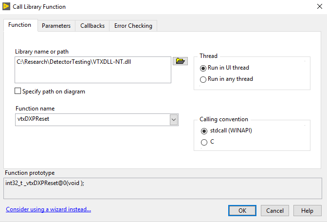

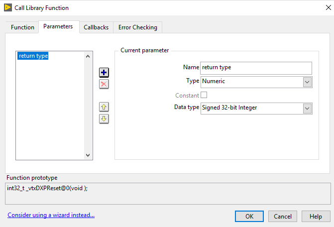

Thanks for your posts, rolfk, I have been reading quite a few over the past few days trying to figure out issues I'm having with a C++ DLL in LabVIEW. Unfortunately, I do not know C++ and am not sure how to move forward with my project.
I am trying to automate data acquisition with a Hitachi Vortex-EX X-ray detector but am getting inconsistent results. The software that comes with the detector consistently functions correctly but cannot be automated, hence the use of LV.
I am running 32-bit LV2017 on a 64 bit Windows 10 environment, both are fully updated.
The library (VTXDLL-NT.dll) has many dependencies, all of which I keep in the same folder as my VIs. The manual states that the library was "developed on the Win32 platform with Microsoft VC++ 6.0 under Windows 2000/XP and was designed to accept calls from C++, C or VB programs."
I have used both the "Import Shared Library" wizard as well as the "Call Function Library Node" to try to connect. After a call fails, I power cycle the instruments and copy over "clean" versions of all the DLLs. Sometimes this causes the functions to work (about 30% of the time).
Based on other posts, I am wondering if the library requires a C wrapper before being wrapped in a LVwrapper, but I could be mistaken.
As an example, I have what appears to be a simple call to the function vtxDXPReset(). From the manual:
int vtxDXPReset( );
Arguments : None.
Remarks : Function performs DXP reset. It can be called whenever an abnormal DXP condition occurs. For example, in the cases of sudden appearance of abnormal noise peaks, sudden peak broadening or shift, the Status or Rate indicator on the electronic box becomes red constantly or the yellow I/O indicator stays on without flashing during the acquisition, etc. It returns 0 if successful, or an error code if function fails (see Appendix).
My LabVIEW code is as follows:
and the Call Function Library Node is configured as:
As I've said, this request works every time through the accompanied Pi-Spect software but only sometimes in LV. There are two different results when it fails, 1) I will either get the 1097 error through the LV error handler or 2) the function will return with a 1001 error code, "Error loading XIA Systems." XIA refers to the manufacturer of the electronics downstream of the pre-amplifier and there are several associated DLLs that have "xia" in the name.
I have tried both calling conventions and specifying the full path in the VI diagram without consistent success. I have also tried all the different data types including "void".
Please let me know if I am leaving out any important pieces of information. Thank you for your time and assistance.
