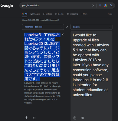

Labview5.1で作成されたviファイルをLabview2013以降で開けるようにバージョンアップしたいと思います。変換ソフトなどありましたらご紹介いただけませんでしょうか。用途は大学での学生教育用です。

Google translate is pretty helpful. He wants to upgrade VIs saved in LabVIEW 5.1 into a more recent version. The last version that could read those VIs is LabVIEW 8.2x. There used to be a conversion package you could request and NI would send you an installer that was basically a bare bones 7.1 LabVIEW version. But that was 20 years ago and I don’t think they still have that VI conversion package available nor that anyone in NI support would know about that.
If it is about a limited number of VIs I would recommend to post them on the Version Conversion board in this forum.
