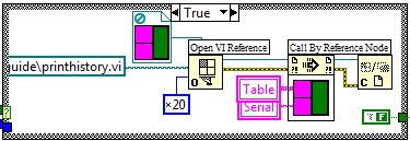

I am using LabVIEW 8.21. I have a rather complex program, Main Panel.vi, that I build as Main Panel.exe and deploy on a device. Recently I created a new subVI, printhistory.vi. I wanted this subVI to be flexible so that I could change how a report prints by modifying the single printhistory.vi file without changing and re-building the Main Panel.exe. So I call the printhistory.vi from within Main Panel.vi using Call By Reference Node. In the application builder, I included printhistory.vi as a Dynamic VI in the Destination Directory. The build was successful and I copied the Main Panel.exe and printhistory.vi files to the target device. Everything functions as intended.

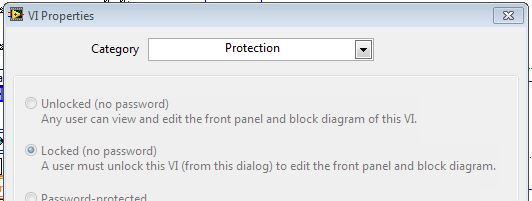

But now I want to make a small change to printhistory.vi. All I'm trying to do is add one more \n to a printout. But my printhistory.vi file is locked. I can't get to the block diagram, and all of the VI Properties are grayed out.
How can I unlock the VI? Is my block diagram permanently gone?

Hi jRhodes,
It looks like your VI was saved without a block diagram as per this KnowledgeBase article:
KnowledgeBase 2N7DBEEW: What Happens When I Save My VI and Remove Diagrams?
http://digital.ni.com/public.nsf/allkb/FEE732F4B1541B9586256BF0006A78CA
I believe that this is done by default in LV 8+ build specifications when building an executable with VIs included. There isn't a way to modify the VI once this has been done, but if you still have the original (source included) VI you should just be able to swap them out.  Alternately, you could rebuild the exe and VI with this option deselected.
Tom L.
(3,438 Views)

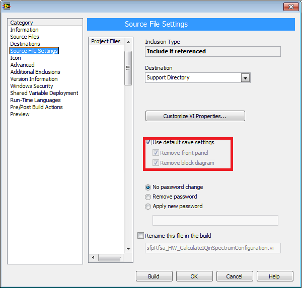

When you included printhistory.vi in the build as a dynamic VI, did you uncheck the "remove block diagram" option? If not, then yes, the block diagram is gone and you'll need to go back to your original source. The default behavior is to remove the block diagram for all VIs set as Always Included.

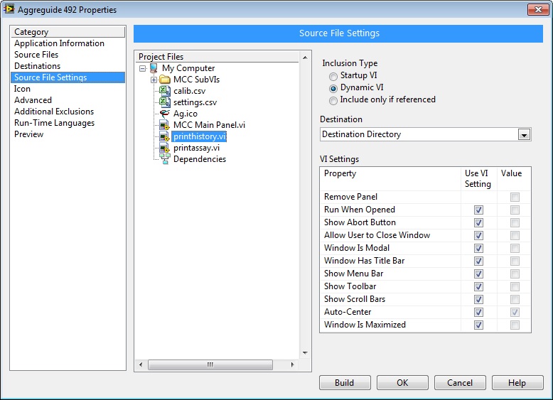

0utlaw and nathand, thanks for the replies.
I don't see the "Remove Block Diagram" option in the source file settings for LabVIEW 8.21. This is my window:
Also, my original source copy of printhistory.vi is the file I am trying to open and modify. I'm checking with the IT guys here to see if there's a saved backup copy from last week pre-build, but barring that there is no original vi that still gives me access to a block diagram. As far as I can tell, building the Main Panel.exe seems to have removed the block diagram from my original source printhistory.vi.
