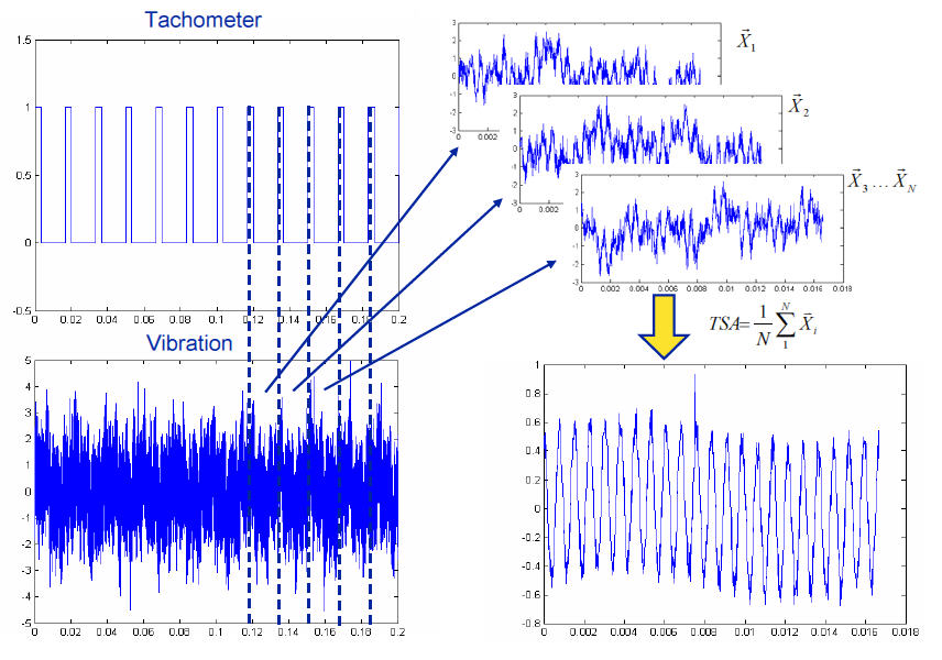

I have project to time sychronous average of gearbox signal, the signal from accelerometer is segmented every certain shaft rotation, the rotation of shaft is measured using  tachometer, then the segments average, the whole process is shown in  image below, could please provide some hints on how to apply this in labview

it seem no one come accross this post, I am wondering if can use trigger for this purpose and how to to signal segmentation

to make it Clear; I use DAQmx to acquire the data. And I need to average  together a series from signal segments ( vibration signal) each corresponding to one period of synchronizing signal ( tachometer signal which indicated one rotation of the shaft completed). In another words constant no of samples will be acquired at each shaft rotation and then this samples added to previous samples from previous shaft rotations, and then divided by the total no of shaft rotation. so the problem how to acquire same no of the points at each shaft rotation and then how to do segmentation.

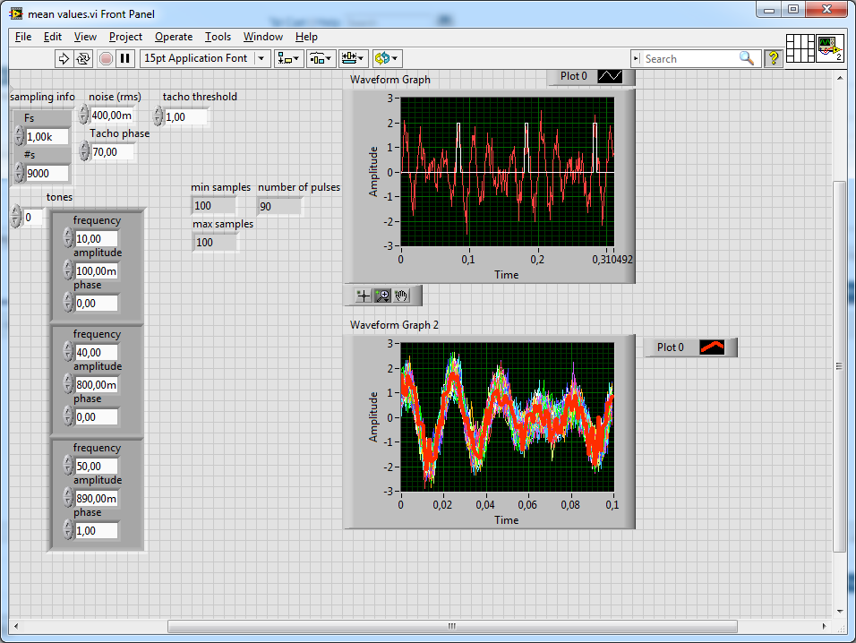

Homework?? However ..
Greetings from Germany
Henrik
LV since v3.1

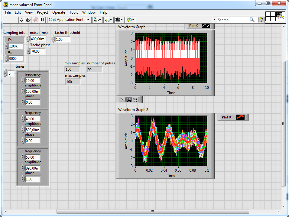

ups there was a bug in that quick shot .....
here the corrected version ...
Henrik

thank you all for these helps, Henrik could you please send the file in 8.5 version as I use old version
