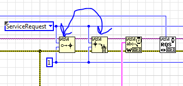

Try reversing these two vis.  there is a slight possibility that you are discarding the event you wanted to wait for since the measurements are being taken all the time. Actually.  you probably want to clear the status register, then flush the event buffer then enable the event.

"Actually.  you probably want to clear the status register, then flush the event buffer then enable the event."

Would be where to direct your feedback.  in 99.995% of all use cases you set up the event then send the command to start the function that results in the event.  This is that odd use case where the data is constantly being acquired asynchronously.  Result: an occaisional race condition that is nearly impossible to reproduce and difficult to troubleshoot  ( I hope you apprciate the skull sweat required to find a potential cause for what you observed):smileywink:
