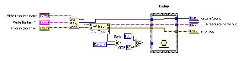

3. I open the project again and I open a sub-VI which contains the following code:
4. Straight away, the file visarc shows up under the Dependencies tree of the Real-Time PXI and the asterisk shows now on the title bar of the project (not the VI).
