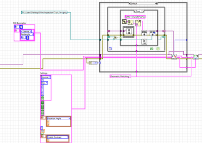

Hi @paripoorman
Based from the error that you have shown, it seems to me that you have inappropriately set-up your template.
I have been using NI Vision Assistant the whole time for my applications and I suggest you might do the same and let Vision Assistant automatically generate the VI for you. If you need greater flexibility and want higher control of your application, then start from that point and modify the generated VI.
As an example, I have used Vision Assistant to set-up a geometric matching template as can be seen on the image below. It is the vi for setting up the template alone and it is obviously more complicated than the sample code you provided.Capture.PNG
Message 5 of 9
(6,398 Views)

Accepted by topic author paripoornan
@paripoorman
There are a number of considerations in setting up a template like ROI, features, contours, edges etc and a lot more settings. If you just based your code on the LabVIEW example, there is a chance that you might not get it working simply because the features on the example template is different from the features of your template.
As a beginner, I strongly recommend using Vision Assistant Express VI as a staring point before going to write on low-level VIs. It will help you do image processing without the need of having to write the code yourself.
