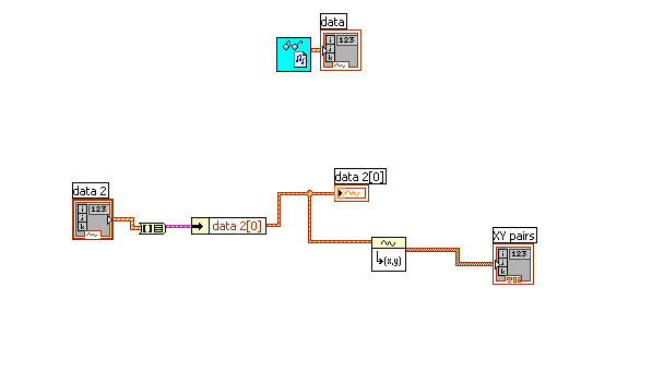

hello im using labview 8.5 and i was wondering how to read data from a wav file and then write the data into 1D array?? thank you... i can actually read the file by using Soun_File_Read.vi , but i need a 1d array..

You can use a reshape array .

You can convert into an array as shown above. Is this what you are looking for?

Use the index array to access the channel you want, then extract the Y array from that sound channel element. Pretty straight forward.
