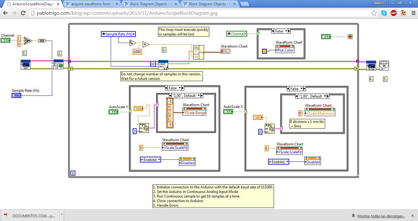

hi! im creating an osciloscope in labview, but im having issues trying to get some items from waveform chart.
i need to get items such as XSCALEMAXIMUM in waveform data type(dark brown)  not on DBL(orange).
i already watch every single video on youtube and also went thorugh many forums. but i still dont know how to get items in waveform data type.
when i give right click on wavefirn chart and select create>property node> Y sacle> range> all elements,,,this si waht i get Screenshot_4.png
but i need this Screenshot_5.png.
this is what im trying to do im i cant see any attempt of convertion.  so it loks like its an option that i dont have available or so.

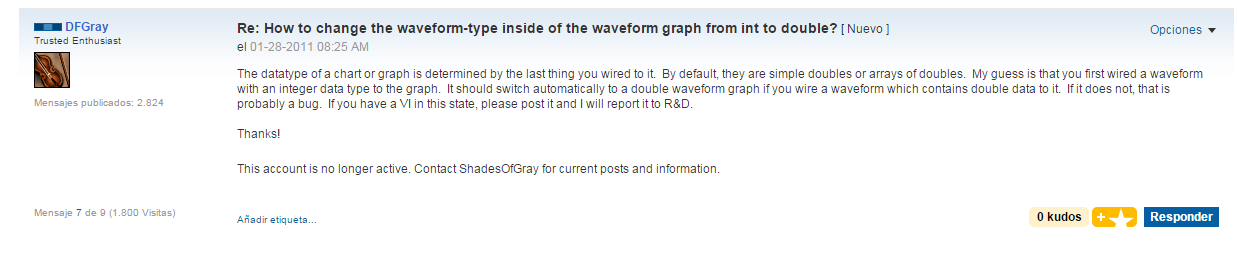

If you connect a waveform to a chart and then create a property node, you'll get the waveform type. If you have a DBL connected and create a property node, you'll get the DBL type. Simple as that.
(4,443 Views)
i dont get it. can you upload an example?  how do i wire  waveform to a chart .  is this what youre talking about?Screenshot_6.png
(4,433 Views)
