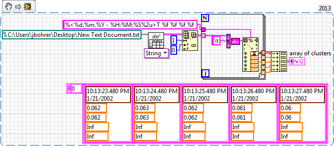

@JohnDoe22222 wrote:
My friend,
How can i use first row of my data file as time channel. Is there a format error in txt file?
Crazy scary working with the scan from string and time in an odd format but that should work
Message 4 of 8
(3,867 Views)

The express vi is not general enough to do what you want.
Try this:
