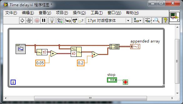

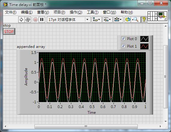

hi DavidJCrawford,
I tried this example, but the change of t0 does not effect the result. I attached my vi and the waveform graph. Please let me know where I went wrong, thx!
Does this problem relating to the "IngoreTimeStamp" or something like that?
Thx in advance!!

Hi Victor,
so you are changing the timestamps just to ignore them afterwards?

Hi GerdW
I was trying to shift a time signal by a half period or so and do a substraction between them. But I was stucked here. I can not shift one channel of the signal!! Could you please help me? Thx

Hi Victor,
you have to find the time range both signals have in common. To do so you should use both starttimes t0 and the duration of the first signal. Then use GetWaveFormSubset to cut that part of both waveforms to subtract them...

Be careful.  There is a setting for the graph under the X Scale to "Ignore waveform timestamp on x-axis".  This is checked by default.  Then you will see your time offset.
Now, as GerdW said, you need to get the two waveforms under the same time frame.  So you have to remove part of the waveforms in order to subtract.
