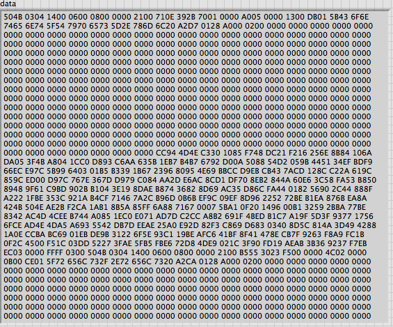

Here is what the file contents look like when read as a binary file and displayed in hexadecimal.
A real csv file would have most of the hex characters starting with 3.

The Read From Spreadsheet File reads text files that have a delimiter of some sort.  Common delimiters are tab and comma.  An XLS file is a proprietary format the Microsoft created.  Only parsers that specifically know the xls (or xlsx) format.  The Read From Spreadsheet File does NOT know this proprietary format.  That is why it doesn't work.
