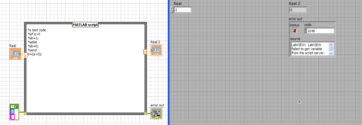

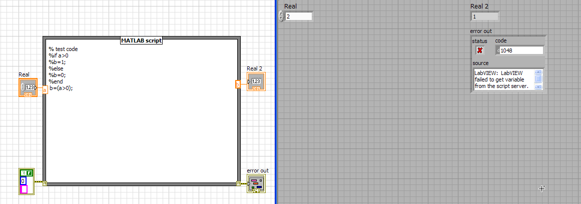

weird matlab script error of boolean condition a=(b>0); [error 1048]
1: a=(b>0); return a 1048 error, and the result of a is wrong.

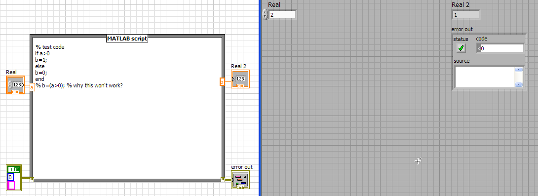

2: modify the above equation using a if-then clause
if b>0
a=1;
else
a=0;
end
3:  comment (2) away, (1) still return a 1048 error but the result is right.
i donot know whether you have experienced the same before, but this error is surely annoyed me and cause a night to debug....
